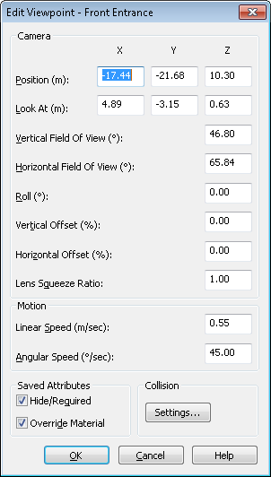

Depending on whether you work in a 2D or 3D workspace you can edit all or some of the following viewpoints attributes, including camera position, field of view, speed of motion and saved attributes. All entries are measured in Display Units.

Edit Current Viewpoints
Click Viewpoint tab > Save, Load & Playback panel > Edit Current Viewpoint
.Use the Edit Viewpoint dialog box to adjust the viewpoint’s attributes.
Click OK.
Note: If you have selected to edit multiple viewpoints, only Saved Attributes are available.
Edit a Viewpoint
Click Viewpoint tab > Save, Load & Playback panel > Current Viewpoint drop-down > Manage Saved Viewpoints.
In the Saved Viewpoints window, right-click the viewpoint you want to modify, and click Edit.
Click OK.
