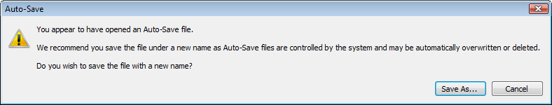

In the event that Navisworks closes before you save changes to your file, you can either automatically reload the last file you were working on, or manually load a backup file.
  1. Open Navisworks.
  2. To open the most recent saved version of the file you were working on, click Yes on the automatic prompt:
  3. To manually load a backup file, Click No on the prompt, and then click the application button > Open > Open .
  4. In the Open dialog box, browse to the folder that contains the backup files. By default, it’s Username\AppData\Roaming\ProductFolder\AutoSave.
  5. In the Files of Type dropdown list, select Navisworks File Set (*.nwf).
  6. Select the relevant file and click Open.
  7. When you are prompted to save the file with a different name, click Save As.
  8. In the Save As dialog box, enter a new file name, and browse to the desired save location.
  9. Click Save.
