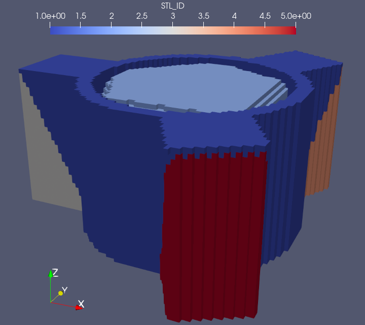

Enables writing the STL ID results to mesh preview and transient results files
*OSID
This card has no parameters.
The STL ID has absolute value 1 for the first STL, absolute value 2 for the second STL, and so on. Unsupported regions get negative values. If the result has a substrate, it gets the number 0.
STL ID visualized in ParaView
