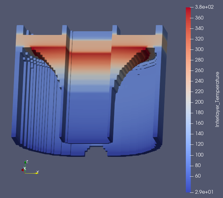

Simulated interlayer temperature, *TCTP card commented out

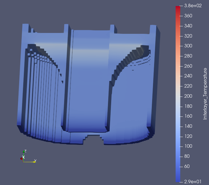

Simulated interlayer temperature, *TCTP card enabled
