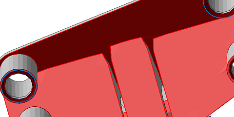

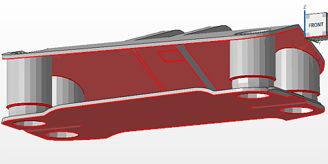

In rare cases, a separate cluster is detected around undercuts or sharp splits for otherwise no apparent reason.
The hollowed-out GE bracket with surfaces requiring support. Cluster detection found a separate cluster on an otherwise continuous surface
This happens when triangles are found to qualify for support multiple times. To help with detection along such conflicting contours, use Texture and color to define facegroups that create artificial segmentation of the downskin.
The Downskin where facegroups have been applied to enforce cluster segmentation. The darker area is a separate facegroup. |
NC-10955 |
