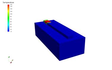

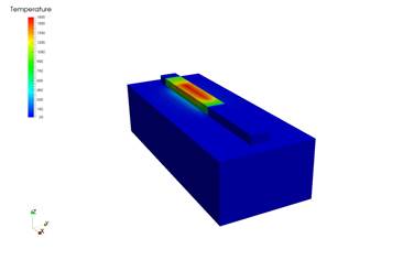

An illustration of the effect of using *LINQ is given in the following figure for the same simulation without using *LINQ (Figure a).

(a) *LINQ = off
(b) *LINQ = 5
(c) *LINQ = 10
