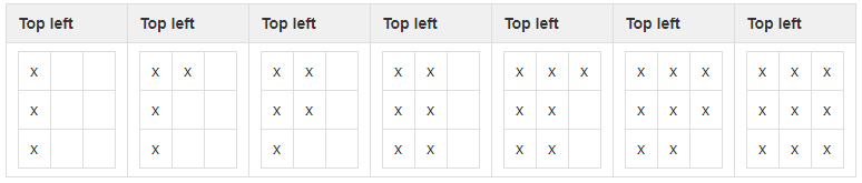

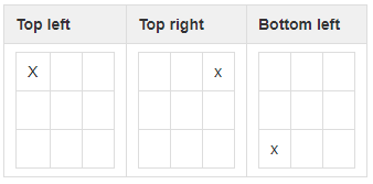

The algorithm splits up the platform into areas:
Depending on the direction parameter, only one field is selected at first:
Geometry that is completely covered by this region is printed first. Now a new cell is added to the selection:
New geometry may be printed as well. This process continues until all regions are accounted for.

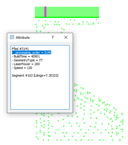

At this point we retrieve tagged toolpaths at a user defined granularity. Now the toolpath elements have to be sorted. Each element already has a default sort value, which is called _processing_order. It is an attribute that can also be seen at the toolpath preview:
By manipulating these attributes, it is possible to change the toolpath processing order using Postprocessing/postprocessing.js:

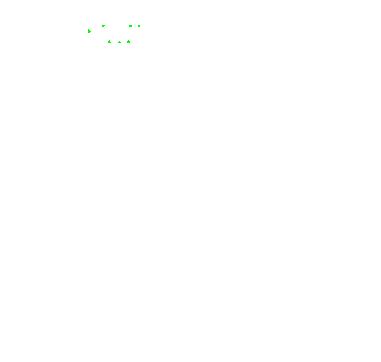

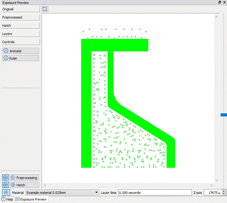

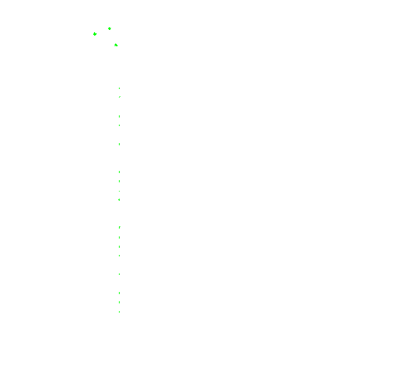

The sorting result can be visualized using the animation option of the exposure preview widget:
