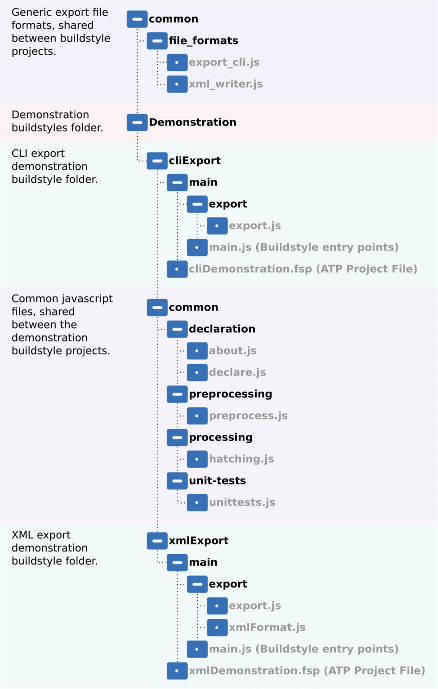

The Advanced Toolpath Utility project files can be found here: demonstration/cliExport and demonstration/ xmlExport.
The export JavaScript code is generic and shared across multiple buildstyle projects. Most of the processing code is shared between the two buildstyles. You’ll find two common source folders called common in the main directory and in the demonstration directory of the tutorial source code folder, located at: (Your documents folder)\ATU-Examples\buildstyles

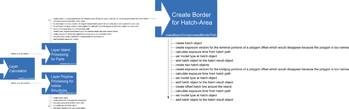

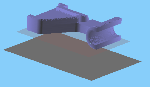

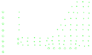

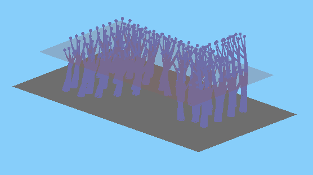

This is the most interesting and complex part of the demonstration buildstyle. The 2D shape data of every layer is used here to create hatch patterns. The density of these hatch patterns is so high, that the final result is a solid area, completely filled with building material.
Here's how the processing steps with the following part and fitting support structures will look:
Calculation Start
It starts at processing/hatching.js with makeExposureLayer:

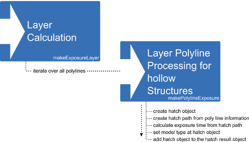

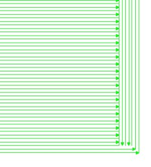

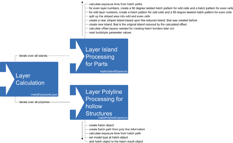

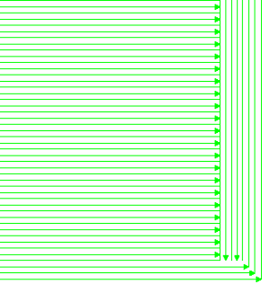

For all layers the makeExposureLayer function iterates over all islands (closed 2D areas) and all polylines (not necessarily closed polygon lines). The polyline hatching is rather simple:
| Processing | Result |
Calculation Start

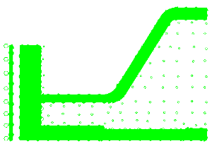

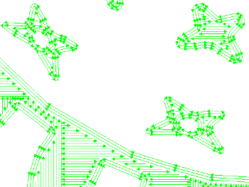

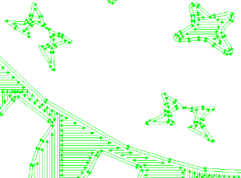

Island Processing
The island processing without creating a beam compensated border:
Full Processing
| Processing |
| Result |
| Before/After results on another part |
