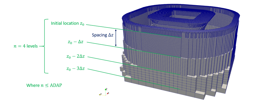

Enables aggressive z-coarsening for the local stage of global-local models
*ZCOA
This card itself has no parameters.
Defaults should suffice for many cases, otherwise the related cards *ZCO0, *ZCOD, and *ZCON control the gradient of aggressive z-coarsening.
z-coarsening and the relationship between the various, optionally adjustable parameters
