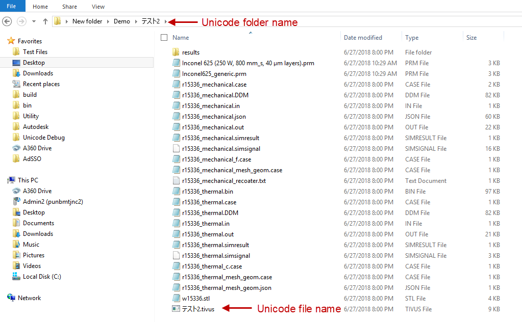

The figure below shows the files produced with Unicode (Japanese) names for the TIVUS file and the project folder.
Note that for the input and output files, the Unicode characters have been replaced with a random ASCII string, r15336, except for the STL file which has a slightly different string, w15336. The STL file is included in the thermal.in and mechanical.in ASCII files, so it must have an ASCII name. If the project includes multiple STL files, Local Simulation provides them with unique names.
