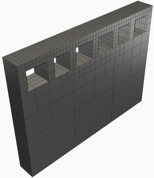

- Select mesh settings appropriate for the size and complexity of the component.
- Generate a
Mesh Preview to ensure adequate voxel representation of the source geometry and to check for flaws in the mesh that could affect simulation results.

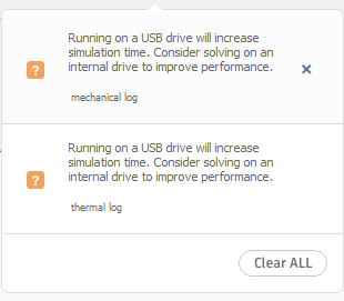

- Check any notifications in the top right of the screen as they appear, or
review the log files for errors or warnings.

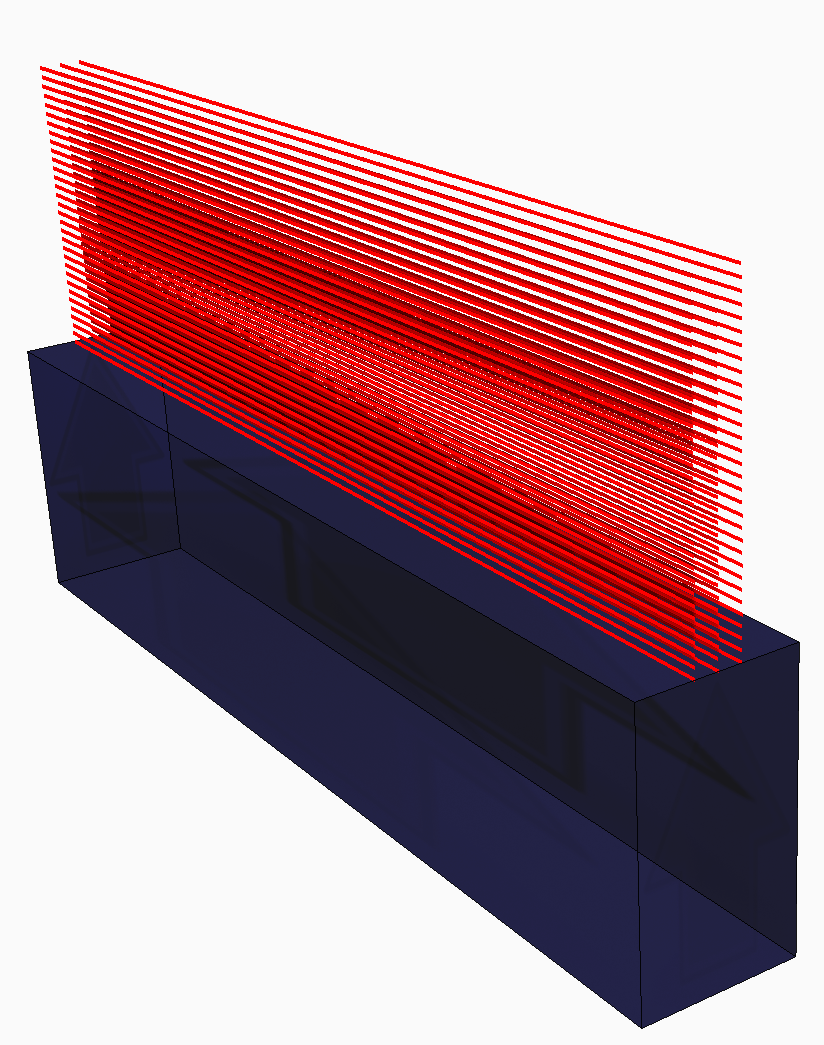

- You are now prompted to open
a laser vector (LSR) file. An LSR file specifies the power, speed, laser spot size, beginning and end points, and timing of the laser vectors to build a DED component.

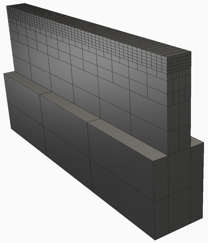

- Generate a mesh preview to ensure adequate voxel representation of the source geometry and to check for flaws in the mesh that could affect simulation results.
