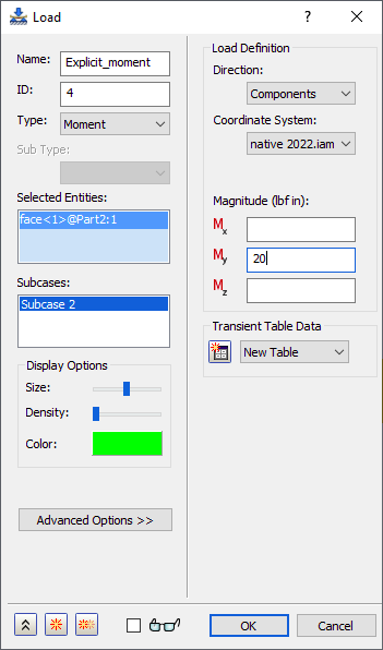

Moment load support in Explicit analysis
Inventor Nastran now also supports adding moment load for both Explicit Dynamics and Explicit Quasi-static analyses.
