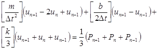

Using these average values:
We then rearrange the terms to end up with the unknown
on the left side and the known
and
on the right:
To solve this equation, we need to calculate the four A terms, then decompose (invert) the
term to find
. It should be noted that for a problem with a constant time step that
need be decomposed only once. However, if the time step changes, it will be necessary to do the calculation again. Thus, it is advisable to maintain a constant time step unless changing it will offset the extra cost.
