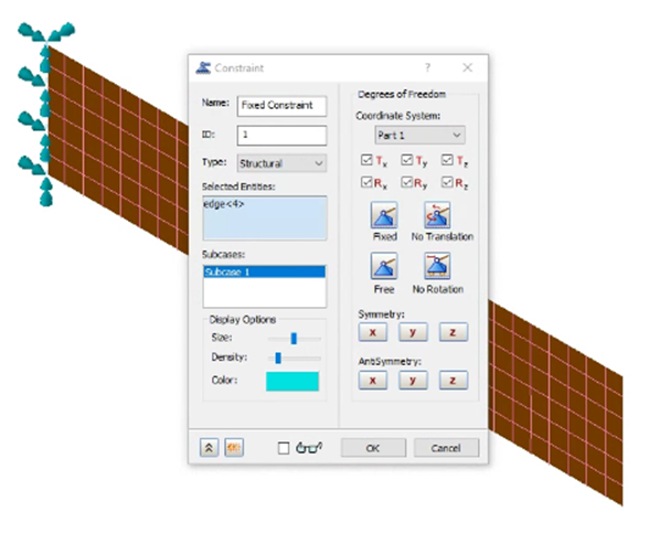

The beam will be fixed at one end to represent a cantilever beam.
  1. In the Part tree, under Subcase 1, right-click Constraints > New.
  2. In the Constraint dialog, change the Name to Fixed Constraint.
  3. Select the back edge of the beam, as shown, and ensure that Subcase 1 is selected under Subcases.
  4. Leave the default constraint settings, and click OK to create the constraint.
