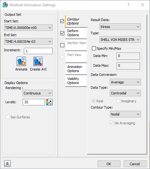

For this example, you will animate the results to see the oscillations of the cantilever beam.
  1. Right-click Results > Multiset Animation Settings.
  2. Select Start Set as TIME:0.000000e+00 and End Set as one of the higher values, such as TIME:4.000812e-03.
  3. On the Contour Options tab, set Result Data to Stress, and Type to SHELL VON MISES STRESS.
  4. Click the Animate button to see the multiset animation. To stop the animation, click Animate again.
