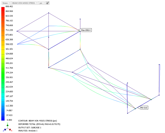

Display a Contour Plot
Finally, we can complete the rule by adding a command to create a contour plot after the solution is complete.

  5. Click OK when the solution is complete to view the contour plot.
