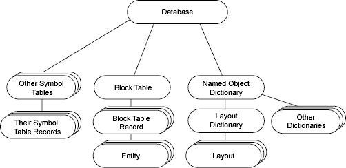

    The layout dictionary is a default dictionary within the named object dictionary that contains objects of class AcDbLayout. The AcDbLayout object stores the characteristics of a paper space layout, including the plot settings. Each AcDbLayout object also contains an object ID of an associated block table record, which stores the entities associated with the layout.
