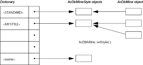

    MLINE Style Dictionary
    The MLINE style dictionary contains objects of class AcDbMlineStyle. As shown in the following figure, objects of class AcDbMline each have an associated MLINE style that specifies the properties of the multiline, such as offset, color, and linetype.
