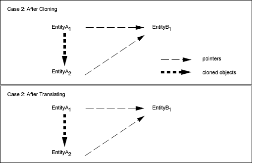

    Translation Phase: Case 2
    As an example of Case 2, suppose you have the same two entities: Entity A 1 contains a pointer reference to Entity B 1 . Entity A 1 is cloned, but Entity B 1 is not. The source and destination (cloned) objects are in the same database.
