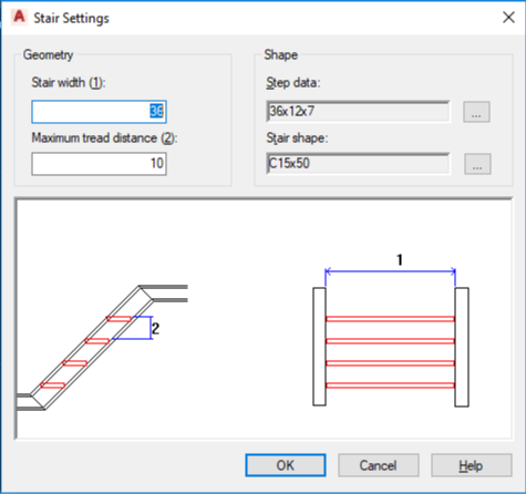

To specify stair settings
- On the ribbon, click Structure tab
Parts panel
Settings menu
Stair Settings.
- In the Stair Settings dialog box, enter the desired geometry values.
- To change step data:
- Under Shape, Step Data click the [...] button, In the Select Step dialog box, make desired changes and click OK.
- To change stair shape:
- Under Shape, Stair Shape click the [...] button, In the Select Stair Shape dialog box, make desired changes and click Select.
- Click OK.
