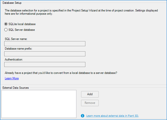

Displays database information supplied during the project-creation process.
Database Setup
- SQLite Local Database
- When selected, indicates that the project uses the default SQLite database.
- SQL Server Database
- When selected, indicates that the project uses the SQL server database.
- SQL Server Name, Database Name Prefix, Authentication
- Displays the information supplied during project creation.
External Data Sources
Manage the properties mapped from external data sources in Project Setup.

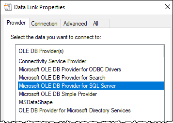

- Add
- Adds and configures the connection strings to data sources in the Data Link Properties dialog box.
- Remove
- Removes the selected external data source.
