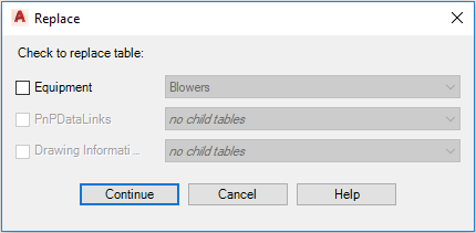

Replace Dialog Box
Replaces the family table used for a report, if one is available, with one of the available object tables.
Sets the report types users can run on a project. Default report types include Equipment List, Line List, Line Summary List, Instrument List, Valve List, Nozzle List, Control Valve List, and Document Registry. You can add, modify, delete, and preview the report types
Check to Replace Table
Controls the family tables you can replace with an object table. To replace a family table, select the check box for the family table you want to replace. Then, in the drop-down list to the right of the check box, select an object table.
Note:
The available object tables that can be used for replacements are dependent on the current parent for the report.
Continue
Returns you to the Create Report Template dialog box.
