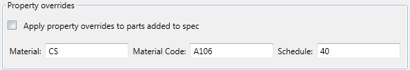

To add components to a spec
  1. On the Catalog pane, select Apply Property Overrides to Parts Added to Spec.
  2. In the Material box, enter a material (for example: CS).
  3. In the Material Code box, enter a material code (for example: A106).
  4. In the Schedule box, enter a schedule (for example: 40).
  5. Specify a size range (for example: 2” to 12”).
  6. Click Add to Spec.
    Note: To modify additional properties, such as Long Description, you can Edit Parts in the Spec Sheet pane after the part is added to the spec.
