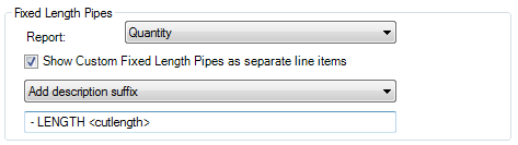

You create Ortho drawings for fixed-length piping the same as you do for other piping, except that you have an additional option for the Ortho BOM.
When creating an Ortho BOM for fixed-length piping, you can set up the BOM to report custom length (shorter than the maximum length) on separate lines in Table Setup.

Similar to an Ortho bill of materials (BOM), Iso BOM allows you to specify piping that is custom length (shorter than the maximum length) on separate lines.
Ortho and Iso BOM
Bill of Materials reports allow you to list each length of fixed-length piping on a separate line item.
For more information see Settings Tab (Table Setup Dialog Box).
