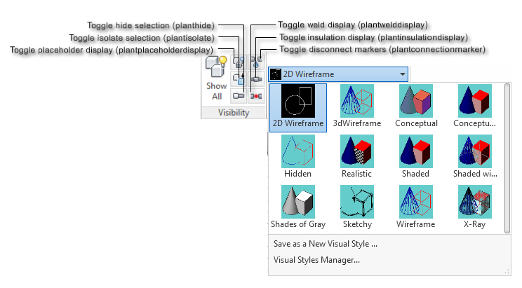

Tip: You can easily hide or show disconnect markers by clicking the icon in the ribbon.
You can change the display style to show your model more or less realistically, depending on your performance requirements. You can also show or hide individual Plant 3D objects.
The Visibility panel and expanded View panel on the Home tab give you control over the appearance of your model and the speed with which you can browse through it.
You can improve performance by turning on disconnect markers only when you need them, by operating most often in 2D wireframe mode, and by breaking up large drawings and using external references.
Select an Optimal Visual Style
By reducing 3D display detail, you can improve performance. You can experiment with various visual settings to find the balance between realistic appearance and performance that works best for you.
If you decide on a wireframe style, you can select either 2D or 3D, with the former providing greater performance benefits, especially for large models. Objects in 2D wireframe look similar to those in 3D wireframe.

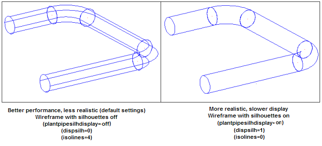

When you use a wireframe visual style, you configure display settings specific to that style and different from those set for a realistic visual style.
You can configure the wireframe visual style to display true silhouettes, for example. If you change back to a realistic visual style, you can turn off silhouettes to improve display performance.

plantpipesilhdisplay Off Turns off pipe silhouettes

dispsilh Off Hides silhouette edges
isolines 4 Displays this number of contour lines per surface on objects
