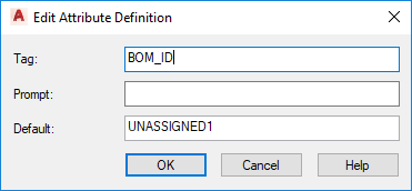

  10. In the Block Editor, double-click on the attribute definition.
  11. In the Edit Attribute Definition dialog box, in the Tag box, enter BOM_ID.
  12. Click OK to close the Edit Attribute Definition dialog box.
