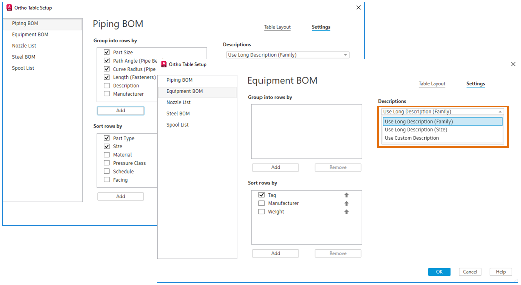

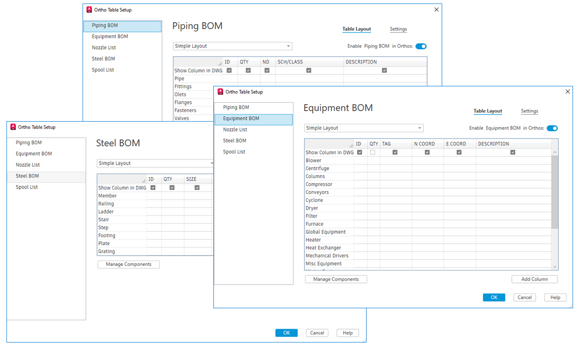

Piping, Equipment, and Steel BOM Customization
You can place the bill of materials (BOM) for piping, equipment, and steel into ortho drawings. Additionally, you can choose the components and properties to show in the BOM. Components are grouped in a row and can be sorted according to their properties.
You can also choose to display the long description (family), long description (size), or custom description in the BOM.

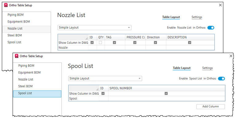

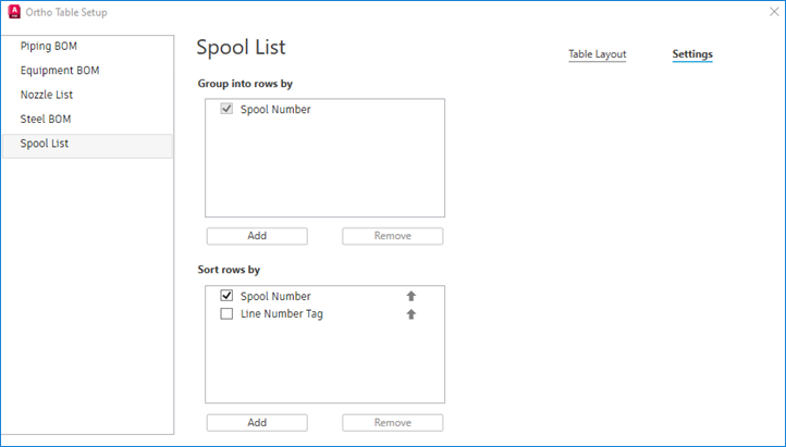

Nozzle and Spool Lists Customization
You can place nozzle and spool lists into ortho drawings and choose which properties to show in the list.
Note: Use PLANTORTHONOZZLEDIRECTION to display the nozzle direction the same as the nozzle attachment port or the nozzle port in the Ortho Nozzle list.
Note: Only spools with assigned spool number are displayed in the spool list.
