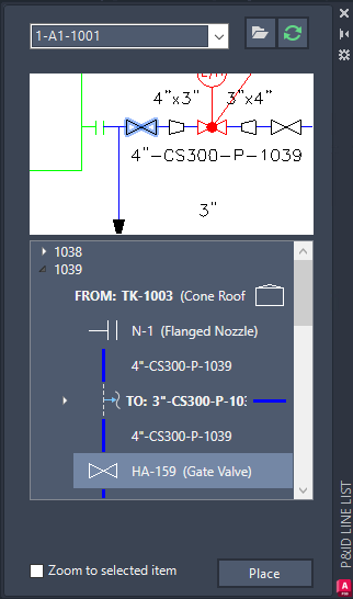

- Open a Plant 3D model.
- On the ribbon, click Home
Part Insertion panel
P&ID Line List.
- In the P&ID Line List window, do the following:
- In the drop-down list, click the P&ID drawing whose lines and components you want to view.
- In the tree view, expand the Pipe Line Group. Click an item (for example: Gate Valve).
- Click Place.
Note: Placing unmapped items display the Custom Parts dialog box. You can follow the steps in the dialog box to build custom parts. - Do one of the following:

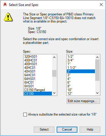

- If the size and spec match, go to step 5.
- If the size or spec do not match, in the Select Size and Spec dialog box, do the following:
- Under Spec, click a spec (for example: CS150).
- Under Size, click a size (for example: 4”).
- If you are sure that your choice is accurate for all situations, select the check box labeled Always Substitute the Selected Size For [size]. (The spec is not saved along with the size.)
- If the size you want is not available, click Edit Size Mappings to edit the default mapping file.
- Click Select.
