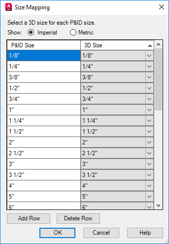

    • If you have attempted to place an object and the Select Size and Spec dialog box is displayed, click Edit Size Mappings.
    • If you want to edit size mappings but the Select Size and Spec dialog box is not displayed, at the Command prompt, enter plantpidsizemapping.
  3. In the Size Mapping dialog box, do the following:
    1. Click Imperial or Metric, depending on your needs.
    2. In the P&ID Size column, click a size (for example: 3/8”).
    3. In the 3D Size column, in the drop-down list, click an appropriate matching size (for example: 3/8”).
    4. Continue mapping sizes as needed.
    5. To add a new mapping, click Add Row.
    6. Click OK.
