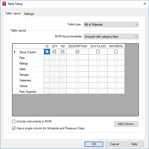

  5. In the Table Setup dialog box, Table Layout tab, do the following:
    • Next to Table Type, select a type from the drop-down list.
    • (Applies to BOM only) Next to BOM Layout Template, select a template from the drop-down list. Choices include Simple BOM, Grouped with Category Titles, or Grouped with Independent Columns.
    • Select or clear the check boxes to specify which fields to include in the BOM or list.
    • Right-click to rearrange rows in table. You can also drag and drop columns.
    • To add a column, click Add Column. In the Select Class Property dialog box, select a property for inclusion as a column header. Click OK.
