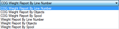

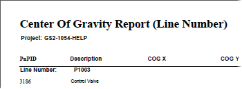

COG Reports
You can display the COG and total weight in a report.
You can create COG and Weight reports directly from the 3D model. Report Creator must be installed to create COG reports.

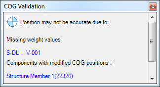

Live COG Validation
If live COG is enabled and you select a Plant object that does not have weight, a validation window displays to identify the components that are missing weight. Live COG validation is not enabled if no selected component has weight.
Plant objects are identified by tag in the validation window. An ID number (PnPID) is used if a tag is not set.
You can enable and disable validation ( plantcogvalidationswitch ).
