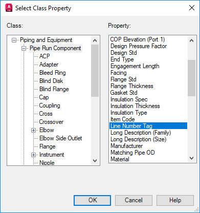

  3. The Select Class Property dialog box, under Class list, click Pipe Run Component.
  4. Under the Property list, click Line Number Tag.
  5. Click OK to close the Select Class Property dialog box.
