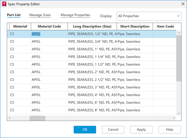

Modify Component Properties in a Spec
  1. In the Spec Editor, on the Spec Sheet pane, click a part (for example: PIPE, PE, ASME B36.10).
  2. Click Property Editor.
  3. In the table, select a cell and enter a value. For example, specify API5L in column Material Code.

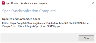

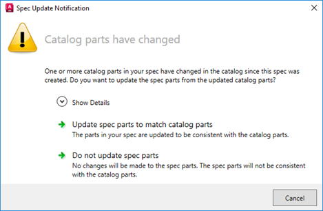

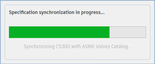

Update a Spec with Catalog Changes
  1. Click Specs menuCheck for Updates from Catalogs.
    Spec synchronization starts.
  2. When finished, the Spec Update Notification dialog box displays. Choose whether to update spec parts to match the catalog parts or not.
