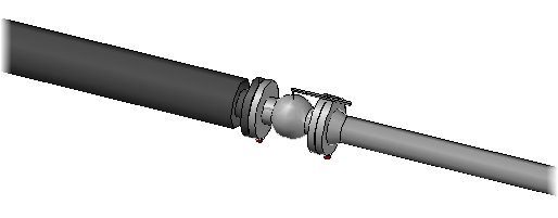

Insulate Piping
You can add insulation to a pipe line by setting insulation properties and using a display command to control insulation visibility.
You can assign insulation to a pipe line using Data Manager, or to individual pipe components using the Properties palette.
You can display or hide insulation using the plantinsulationdisplay button on the ribbon.
