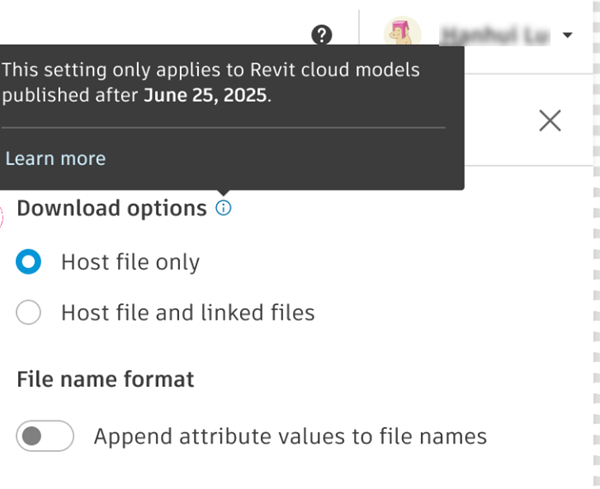

Download Source Files
Members with View + Download permission or above can download files, and folders that contain files. You can't download Data Exchanges or snapshots of Model Coordination views saved to Docs.
Note: If you want to download Revit Cloud Models with their linked files, see the Download Options for Revit Cloud Models section.
  1. Enable pop-up dialog boxes in your browser settings to download source files.
  2. If you want to download:
    • A single file or folder: Right-click the file and click Download source file.
    • Multiple files and / or folders: Select the relevant files and folders, right-click one of the selected items and click Download source files.
    You can now append up to five attribute values to the file names. If you don't want to do this, click Download.
    Note: Attributes will only be appended to directly selected files. They will not append to files in selected folders.
  3. Turn on Append attribute values to file names.
  4. Click Select attributes.
    You can select from any custom attributes and the following system attributes:
    • Description
    • Version
    • Size
    • Last updated
    • Updated by
    • Review status
    • Version added by
  5. Make your selections as required and click Select.
    Note: Format shows how the attributes display in the file name. You can drag the selected attributes to change the order as necessary.
  6. Click the Delimiter field to choose hyphen, point, or underscore as the delimiter.
  7. Click Download.
  8. Click OK to close the pop-up dialog box reminder.
  9. A copy of the file will download to your local drive.

To download an RCM published after June 25, 2025 that contains links:
  1. Select a single RCM file.
  2. Right-click the file and select Download source file.
  3. In the download panel, you'll see Download options:
    • Host file only (selected by default): Downloads only the selected RCM as an RVT file.
    • Host file and linked files: Downloads the selected RCM and its linked files as a ZIP file
  4. Select your preferred option.
  5. If you want to append attribute values to file names, follow steps 3-6 of Download Source Files.
  6. Click Download.
