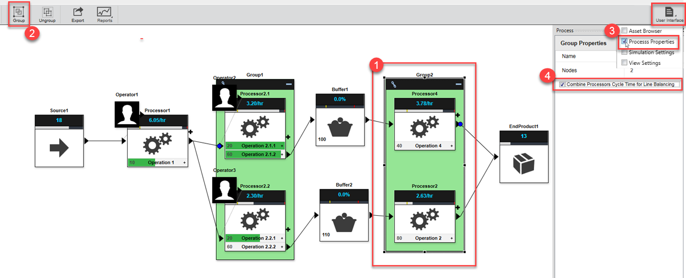

To group objects in your process model:
- Drag your cursor over the objects you would like to include in a group to highlight the objects.
- Select Group from the ribbon.
- Select the Process Properties checkbox from the User Interface drop-down menu.
- Select Combine Processors Cycle Time for Line Balancing from the Group Properties dialog.
- Run the simulation.

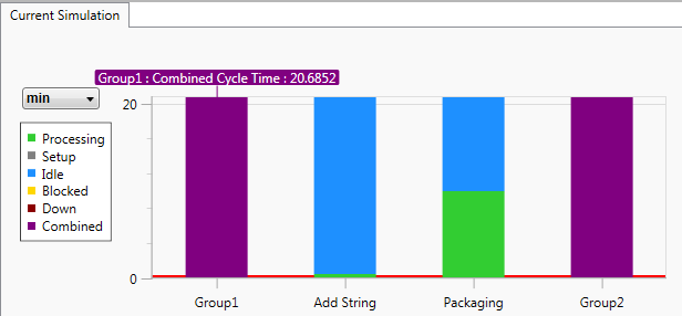

Combined Cycle Time data displays in the purple bars of the line balancing chart for each group.
