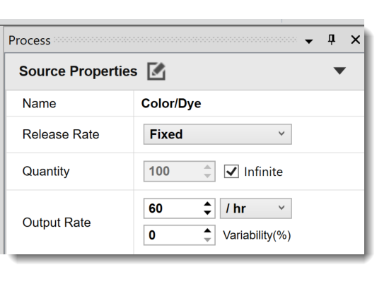

Fixed Release Rate properties
A Fixed release rate indicates a nonvarying output rate and quantity for the resource.
  • Quantity: Number of items available from this source. Select Infinite if there is an unlimited supply.
  • Output Rate: Number of items the source supplies in the selected unit of time. If the rate can vary, enter the acceptable range as a percentage of the output.
  • Variability %: Indicates the acceptable level above or below the mean time setting.

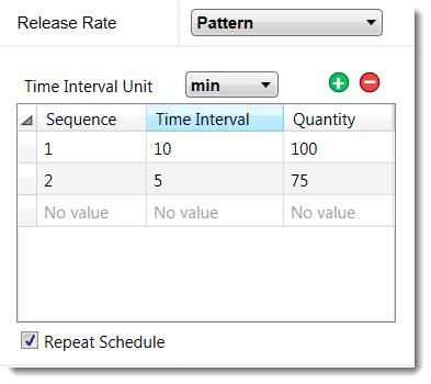

Pattern Release Rate properties
  1. Select Pattern to create an output schedule with variable rates and quantities.
  1. Complete the table working from left to right to add the time required for the first set of outputs and the number of items supplied.
  2. Click + to add a line for the second set of outputs.
  3. Select Repeat Schedule to repeat this schedule indefinitely.
Output Routing options are the same as the Output Routing options for a Fixed release rate.
