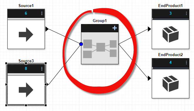

While working in simulation mode, a collapsed group node only shows simulated input and output for the node as a whole. The number of objects and connections are accurately reflected in the shaded group node when collapsed.

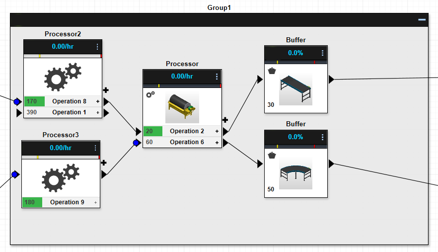

Individual node details appear when the group node is expanded during simulation mode:

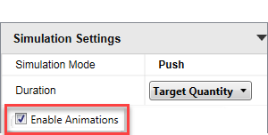

To increase the performance of your simulation, you have the option to turn off individual node details by deselecting the Enable Animations checkbox.
To access this setting, go to User Interface
Simulation Settings
Enable Animations
