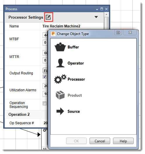

Changing an Object Type
There might be instances where you need to change the object type. For example, factory assets that do not have predefined process properties automatically default to the processor object type when placed in the process model. To change the type to something else, such as a buffer or source, complete these steps.
To change an object type:
- Select the object that you want to change.
- Select the User Interface drop-down menu.
- Select the Process Properties checkbox to view the Process Properties pallette.
Click the edit icon next to the object type to display the available type options.
Select the desired object type and click OK.
- Optionally, you can change the object type by right-clicking an object or asset and selecting Change Object from the context menu. Similarly, you can rename an object by selecting Rename Object in the context menu.
