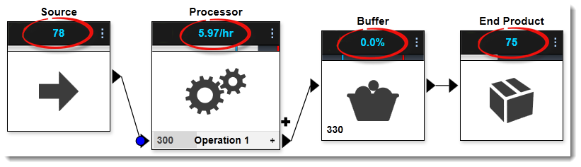

The simulation controls appear at the bottom of the workspace:
As a simulation runs, data appears for each object: sources show quantity emitted, processors show current production rate for the active operation, buffers show the capacity percentage, and end products show the number of processed products.

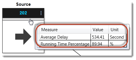

Hover over a Source data bar to view Average Delay and Running Time Percentage.

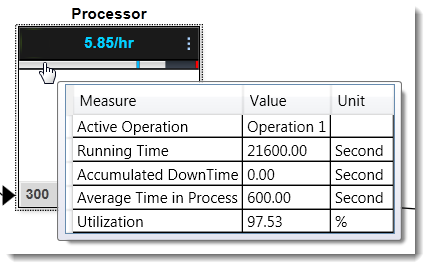

Hover over a Processor data bar to view Active Operation, Running Time, Accumulated Downtime, Average Time in Process, and Utilization.

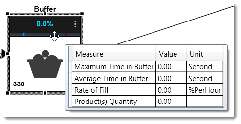

Hover over the data bar on a Buffer to view Maximum Time in Buffer, Average Time in Buffer, Rate of Fill, and Product Quantity.
