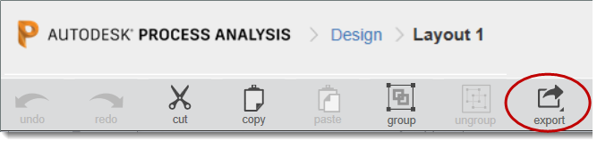

- Select the Export command from the ribbon.
- Choose a filename.
- Select Excel file or AutoCAD Drawings from the Save as type menu.
- Select the local directory in which you want to save the file, and Save.
