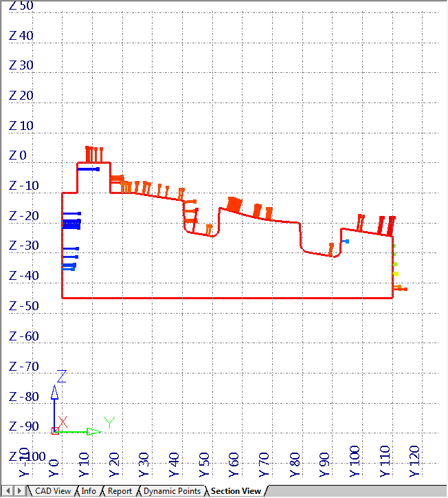

Section View tab
When the document contains a section group, PowerInspect displays the Section View tab. The tab shows the details of the currently selected section group in the inspection sequence.
When you have probed the section, use the View tab to choose how the deviations of measured points are displayed, and to manipulate the view.
Note: Set the background colour of the Section View tab on the Colours > General page of the Options dialog.
