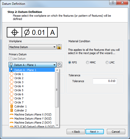

  7. Click OK to create the GD&T Datum item and close the dialog. The item is available for selection in the Datum lists of GD&T measurement items. For example:
You can identify when a GDT Datum item is used in a GD&T item by the background of the reference symbol in control frame: for GDT Datum items, the reference symbol is shown against a white background; for sequence items, the reference symbol is shown against a patterned background.
