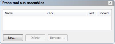

The Probe tool sub-assemblies area of the Machine tab enables you to create and manage combinations of probe parts for use on CNC machines.
To create a sub-assembly
If you want to specify a star probe, first select the Show probe tool connections check box in the Options dialog.

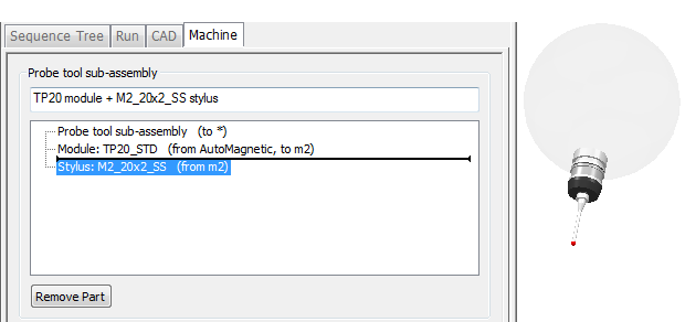

  1. In the Probe tool sub-assembly area of the Machine tab, click New. The Probe Tool Sub-Assembly dialog is displayed.
  2. Enter a name for the sub-assembly in the Probe tool sub-assembly box. The name must be unique to that sub-assembly for PowerInspect to distinguish between different sub-assemblies.
    Note: When PowerInspect connects to the measuring device, it compares the sub-assemblies in the document to that used when it was last connected to the measuring device with the specified protocol. If it finds a matching sub-assembly under a different name, PowerInspect automatically updates the document to the previous name.
  3. In the Available probe tool parts area, select the type of part you want to add to the sub-assembly. The list displays all the parts available in the probe database.
  4. To choose the type of part you want to add, double-click its entry to add it to the sub-assembly. The part is displayed in the CAD view, its name is added to the Probe tool sub-assembly list, and the insertion line moves to show where the next part will be inserted. To change the insertion position, double-click a part in the list to reposition the insertion line after it.
    Note: If you want to create a sub-assembly for use with racks, create it using a TP20 module connected to any compatible extension-stylus combination.
  5. Continue inserting parts until the sub-assembly is complete.
    Note: To remove a part from the sub-assembly, select its entry in the Probe tool sub-assembly list, and then click Remove part.

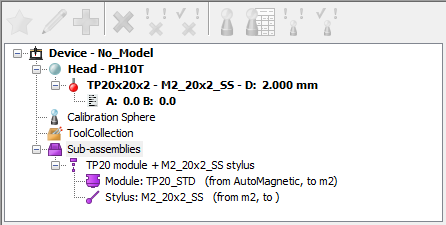

  6. Click Save to save your changes and close the dialog. The sub-assembly's name is displayed in the Probe tool sub-assemblies area and its details are displayed in the Probe View.
    For example:
To rename a sub-assembly
  1. In the Probe tool sub-assemblies area of the Machine tab, select the sub-assembly you want to rename, and then click Rename. The Rename Sub-Assembly dialog is displayed.
  2. Change the Name.
To delete a sub-assembly
  1. Remove the sub-assembly from any probe tool to which it is referenced or rack to which it is allocated.
  2. In the Probe tool sub-assemblies area of the Machine tab, select the sub-assembly you want to delete, and then click Delete. Only the sub-assembly is deleted; the parts making up the sub-assembly remain available for use in other sub-assemblies.
