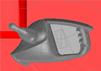

    To highlight back-facing surfaces
    Display back faces of an open or inverted surface in red.
    The direction of the surface normal vector determines front or back facing.
    1. Display the model in a shaded view.
    2. Select View tab > Appearance > Back-Face Highlight.
      The CAD model shows back-facing surfaces in red.

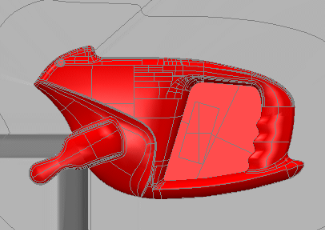

    3. Rotate the model so the view is reversed.
      The colouring changes to show the new back-facing surface.
