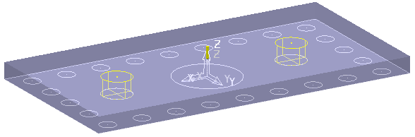

On the model, select the two 18mm diameter circles and then select:
- A Create from of Circles.
- A Define top by of Top of block.
- A Define bottom by of Bottom of block.
- Click Apply and then Close the dialog. PowerMill creates the circle features on the model.
