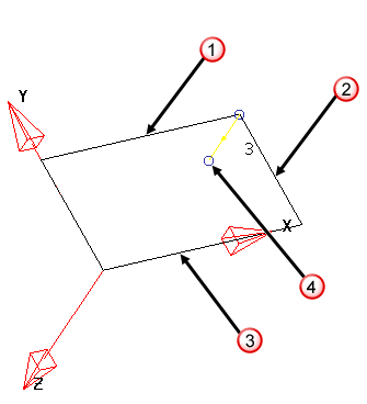

The coordinate system specifies the position of every object within the global workspace. The coordinate system contains the X, Y, and Z axes, which meet in the centre of the workspace, at a position called the origin.
All models are created within the global workspace. Every position in a model is specified as three coordinates. For example, a position of 9,5,3 means 9 along the X axis, 5 along the Y axis and 3 along the Z axis. These coordinates are shown in the image below:
X = 9
Y = 5
Z = 3
Position 9,5,3

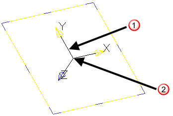

Models can contain many angled faces and it is often easier to specify coordinates relative to a face rather than to the model as a whole. You can do this using workplanes, shown in the image below:
Dimensional axes X,Y,Z
Origin
