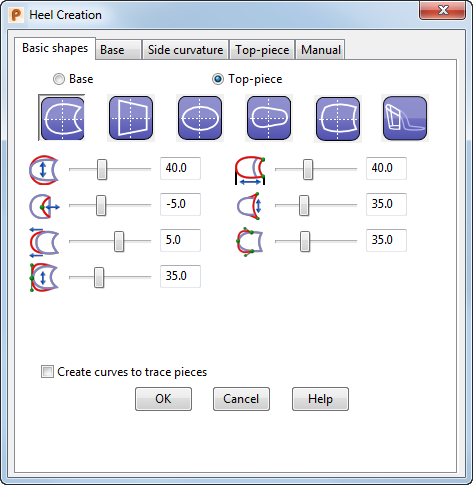

Heel creation dialog - Basic shapes
Use the Basic shapes tab to:
  • specify the basic shape of the heel, using pre-defined profiles for the base and the top-piece.
  • enter parameters for the basic shape when there is no reference surface.
  1. Select Base.
  2. Choose a basic shape. Select:
    Two arcs to create a heel shape defined by two arcs.
    Trapezoid to create a heel shape defined by a trapezoid.
    Ellipse to create a heel shape defined by an ellipse.
    Two arcs and two lines to create a heel shape defined by two arcs and two lines.
    Four arcs to create a heel shape defined by four arcs.
    Default to create a default heel shape.
    Different parameters are displayed for each basic shape.
  3. Enter a value or drag the sliders to change the parameters.
  4. Select the Top-piece tab.
  5. Select a basic shape.
  6. Modify the parameters to create the required shape.
  7. Select Create curves to trace pieces to create curves along the edges of the heel. Use these curves to create pieces on the heel; such as a heel cover or a Louis heel effect at the heel front.
