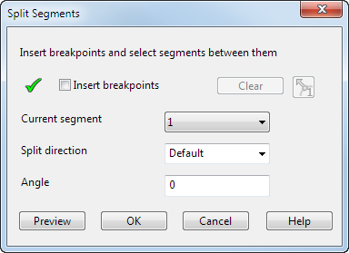

Use the Split Segments dialog to break the split line into smaller segments and use them to define the direction of the laterals in the split surface.

Insert breakpoints — Select this option to insert and remove split segments from the split line.
To insert breakpoints, click positions on the split line. In the example below, two breakpoints have been inserted at the corner
To remove a breakpoint, hold down the Ctrl key and click the breakpoint.
When you have entered the breakpoint, deselect the Insert breakpoints check box.

If you select the Along axis option on the Split surface dialog, breakpoints are added where the curve changes direction. You can edit these breakpoints like the ones you insert manually.
Clear — Removes all selected breakpoints.
Current segment — Select a segment from the drop-down list. The segment is highlighted in the model and an arrow showing the default direction of the laterals
Split direction — Choose a direction from the list. This list contains three directions:
- Default — Uses the direction as specified on the Split Surface dialog. You can reverse the direction of the laterals.
- Radial — Uses the direction along the normal of the split line.
- Along axis — Uses the direction along the axis specified on the dialog. Select an axis from the options displayed.
When you select an option, the arrow changes to the specified direction.
In this example, the Radial option was selected:
To reverse the direction of the laterals to the opposite side of the composite curve, click the arrow.
Angle — Specifies the angle for the segment of the split surface. The default setting is the default angle for the split surface as a whole.
Preview — Displays the direction of the laterals in the whole of the split surface:
OK — Saves the changes and closes the dialog.
To preview the new split surface, you need to click Preview on the Split Surface dialog.
