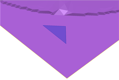

    Use the Delete option to delete the selected triangles in the model:
    1. Select the triangles you want to delete. The selected triangles turn blue.

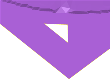

    2. Click Mesh Tools tab > Triangles panel > Delete. This removes the selected triangles:
